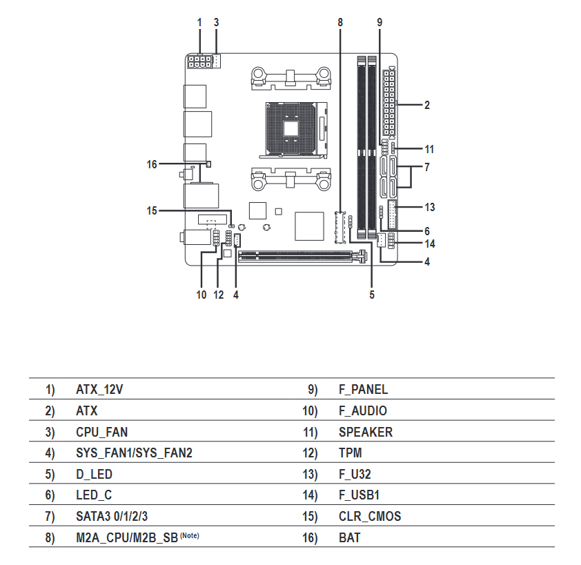

Dann starte ich einen neuen Versuch. Ist das dein Board?
Hier gibt es auch ein Batterie (Punkt 16) BAT), die ist unter der Abdeckung aber versteckt. Die Batterie gibt es immer, sonst würde es konstant dein BIOS zurück setzen, sobald der PC stromlos ist.
15) CLR_CMOS (Clear CMOS Jumper) Use this jumper to clear the BIOS configuration and reset the CMOS values to factory defaults. To clear the CMOS values, use a metal object like a screwdriver to touch the two pins for a few seconds.•Always turn off your computer before clearing the CMOS values.•After system restart, go to BIOS Setup to load factory defaults (select Load Optimized Defaults) or manually configure the BIOS settings (refer to Chapter 2, "BIOS Setup," for BIOS configurations).Open: NormalShort: Clear CMOS Values
16) BAT (Battery) The battery provides power to keep the values (such as BIOS configurations, date, and time information) in the CMOS when the computer is turned off. Replace the battery when the battery voltage drops to a low level, or the CMOS values may not be accurate or may be lost.You may clear the CMOS values by removing the battery:1. Turn off your computer and unplug the power cord.2. Unplug the the battery cable from the battery cable header and wait for one minute.3. Plug in the battery cable.4. Plug in the power cord and restart your computer.•Always turn off your computer and unplug the power cord before replacing the battery.•Replace the battery with an equivalent one. Damage to your devices may occur if the battery is replaced with an incorrect model.•Contact the place of purchase or local dealer if you are not able to replace the battery by yourself or uncertain about the battery model.•Used batteries must be handled in accordance with local environmental regulations.
Was ich damit sagen will, bist du wie in 15) erläutert vorgegangen?
Ja das ist es 🙂

Schau mal auf dem Foto hier bei Punkt 16. Dort erkennst du einen kleinen 2Pin Stecker. Bei Notebooks ist das auch oft so gelöst, damit sie variabel positioniert werden kann, da die CR2032 bei so kleinen Bretten und kompakten System verhältnismäßig viel Platz wegnimmt.
Vermutlich befindet der sich unter der Abdeckung des Boards.
