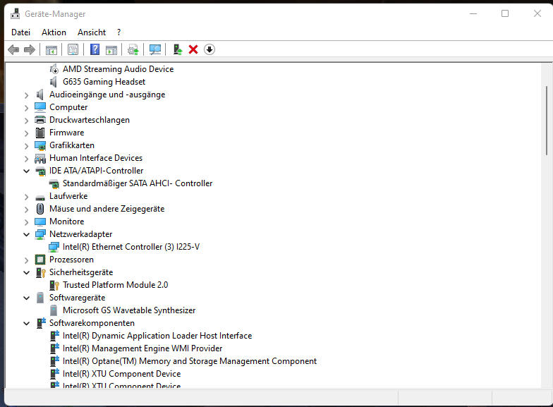

Ich habe soweit auf der Herstellerseite von Asus alle Treiber installiert. Das einzige was mich wirklich dort wunder das im Hardwaremanager unter IDE ATA AHCI- Controller nur der Standardmäßiger SATA AHCI-Controller installiert ist...dort hätte ich eigentlich was von Intel irgendwas erwartet.
Es kann auch vorkommen das HDAudBus.sys hohe Latenzen verursacht.

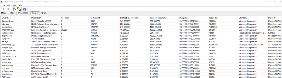

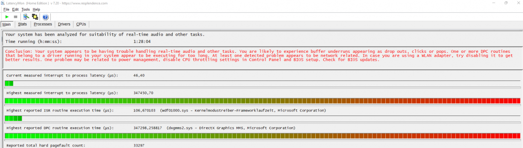

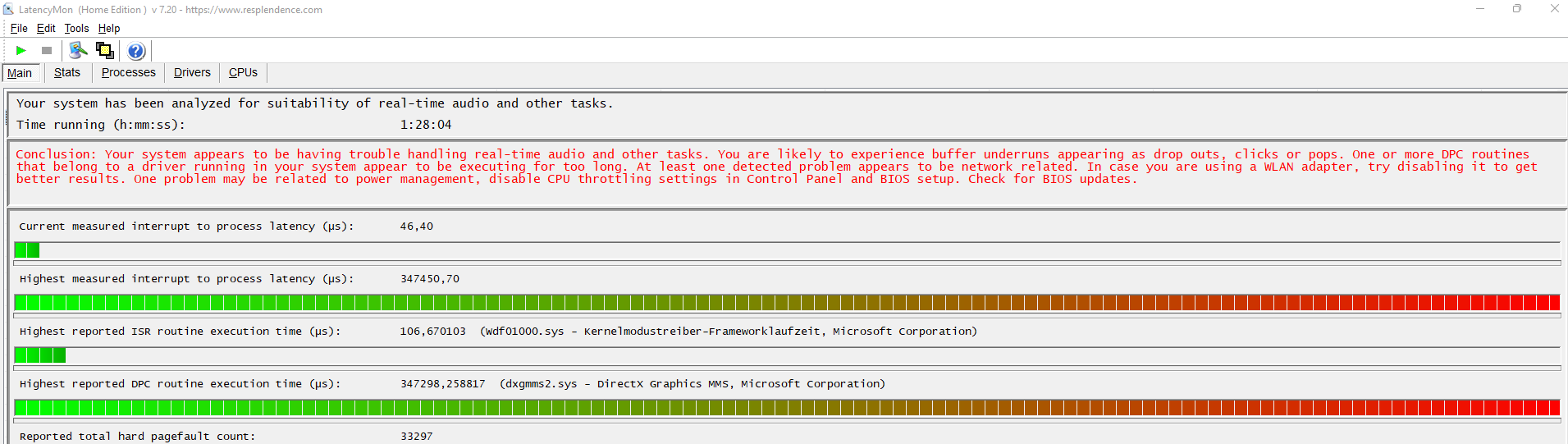

Hier mal ein Auszug vom LatencyMon:
_________________________
CONCLUSION
Your system appears to be having trouble handling real-time audio and other tasks. You are likely to experience buffer underruns appearing as drop outs, clicks or pops. One or more DPC routines that belong to
a driver running in your system appear to be executing for too long. At least one detected problem appears to be network related. In case you are using a WLAN adapter, try disabling it to get better results.
One problem may be related to power management, disable CPU throttling settings in Control Panel and BIOS setup. Check for BIOS updates.
LatencyMon has been analyzing your system for 1:28:04 (h:mm:ss) on all processors.
__________________________
SYSTEM INFORMATION
Computer name: PIEGRO
OS version: Windows 11, 10.0, version 2009, build: 22000 (x64)
Hardware: System Product Name, ASUS
BIOS: 1304
CPU: GenuineIntel 12th Gen Intel(R) Core(TM) i5-12600KF
Logical processors: 16
Processor groups: 1
Processor group size: 16
RAM: 32581 MB total
__________________
CPU SPEED
__________________
Reported CPU speed (WMI): 3701 MHz
Reported CPU speed (registry): 3686 MHz
Note: reported execution times may be calculated based on a fixed reported CPU speed. Disable variable speed settings like Intel Speed Step and AMD Cool N Quiet in the BIOS setup for more accurate results.
MEASURED INTERRUPT TO USER PROCESS LATENCIES
The interrupt to process latency reflects the measured interval that a usermode process needed to respond to a hardware request from the moment the interrupt service routine started execution. This includes
the scheduling and execution of a DPC routine, the signaling of an event and the waking up of a usermode thread from an idle wait state in response to that event.
Highest measured interrupt to process latency (µs): 347450,70
Average measured interrupt to process latency (µs): 4,328458
Highest measured interrupt to DPC latency (µs): 347448,10
Average measured interrupt to DPC latency (µs): 1,510084
___________________________
REPORTED ISRs
Interrupt service routines are routines installed by the OS and device drivers that execute in response to a hardware interrupt signal.
Highest ISR routine execution time (µs): 106,670103
Driver with highest ISR routine execution time: Wdf01000.sys - Kernelmodustreiber-Frameworklaufzeit, Microsoft Corporation
Highest reported total ISR routine time (%): 0,001418
Driver with highest ISR total time: Wdf01000.sys - Kernelmodustreiber-Frameworklaufzeit, Microsoft Corporation
Total time spent in ISRs (%) 0,001418
ISR count (execution time <250 µs): 643220
ISR count (execution time 250-500 µs): 0
ISR count (execution time 500-1000 µs): 0
ISR count (execution time 1000-2000 µs): 0
ISR count (execution time 2000-4000 µs): 0
ISR count (execution time >=4000 µs): 0
REPORTED DPCs
DPC routines are part of the interrupt servicing dispatch mechanism and disable the possibility for a process to utilize the CPU while it is interrupted until the DPC has finished execution.
Highest DPC routine execution time (µs): 347298,258817
Driver with highest DPC routine execution time: dxgmms2.sys - DirectX Graphics MMS, Microsoft Corporation
Highest reported total DPC routine time (%): 0,091882
Driver with highest DPC total execution time: dxgkrnl.sys - DirectX Graphics Kernel, Microsoft Corporation
Total time spent in DPCs (%) 0,138616
DPC count (execution time <250 µs): 18011862
DPC count (execution time 250-500 µs): 0
DPC count (execution time 500-10000 µs): 39
DPC count (execution time 1000-2000 µs): 10
DPC count (execution time 2000-4000 µs): 43
DPC count (execution time >=4000 µs): 33
________________________________
REPORTED HARD PAGEFAULTS
Hard pagefaults are events that get triggered by making use of virtual memory that is not resident in RAM but backed by a memory mapped file on disk. The process of resolving the hard pagefault requires
reading in the memory from disk while the process is interrupted and blocked from execution.
NOTE: some processes were hit by hard pagefaults. If these were programs producing audio, they are likely to interrupt the audio stream resulting in dropouts, clicks and pops. Check the Processes tab to see
which programs were hit.
Process with highest pagefault count: msmpeng.exe
Total number of hard pagefaults 33297
Hard pagefault count of hardest hit process: 13632
Number of processes hit: 81
Den Rest vom LatecyMon muss ich in einem Thread schreiben, max 10000 Zeichen.

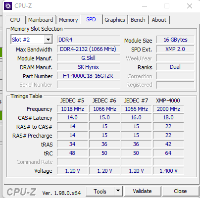

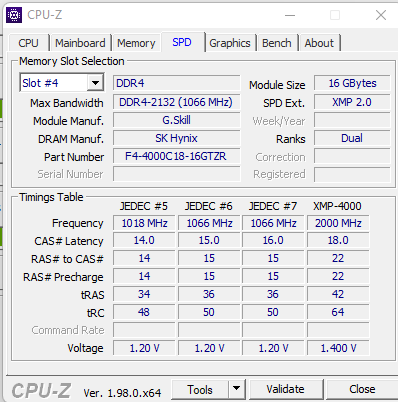

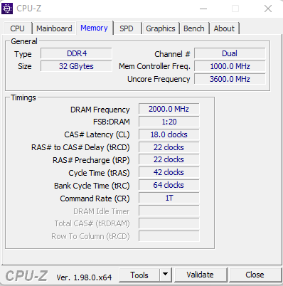

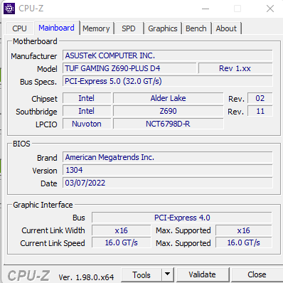

Anbei noch allerhand Bilder.
Ich bedanke mich jetzt schon einmal für jede Antwort und jeden Tipp.

CPU 14 DPC count: 32523
_________________________________________________________________________________________________________
CPU 15 Interrupt cycle time (s): 20,955687
CPU 15 ISR highest execution time (µs): 37,346717
CPU 15 ISR total execution time (s): 0,001052
CPU 15 ISR count: 691
CPU 15 DPC highest execution time (µs): 195,098752
CPU 15 DPC total execution time (s): 0,125059
CPU 15 DPC count: 16695

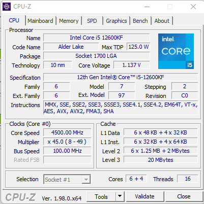

Dein RAM läuft aktuell mit 4000Mhz, die CPU unterstützt maximal 3200Mhz, alles darüber ist übertakten.
Hast du weniger Probleme, wenn du das XMP Profil mit 3200Mhz wählst?

Erstmal danke mit der RAM Frequenz, das ist mir ehrlich gesagt nie aufgefallen, ich werde das morgen ausprobieren.
