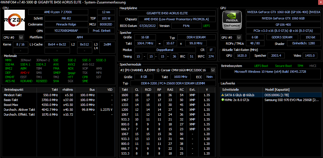

Mein Setup:
Ryzen 7 2700x
Palit GTX 1060 6gb Super Jetstream (531.29)
Aorus Elite B450 UEFI F64c
Corsair Vengeance RGB (ich glaube Pro) 2x8gb
Intel AX200 Wifi+BT Adapter
Samsung SSD 970 EVO Plus 250GB
1TB 2,5 Zoll HDD (Keine Ahnung woher)
Windows 10 10.0.19045
